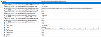

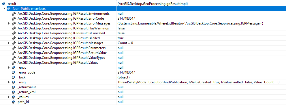

Common to all four ways of specifying the toolPath parameter, is that I get the value 2147483647 as the ErrorCode from the returned IGPResult as shown below:
If I replace toolPath and args with a standard Esri tool, it works fine.
If I run my Python-tool from within ArcGIS Pro GeoProcessing, it works fine.
If I run my Python-tool via an ArcGIS Pro Python prompt, it works fine.
What am I doing wrong?
