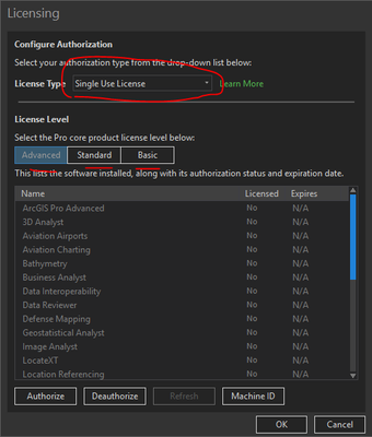

Do you have a single use license or a named user license?
Which version did you purchase a license for? (Advanced, Standard or Basic)
If you have a named user license that should be available when you log on using your ESRI ArcGIS Online credentials.  If you have a single use license, please make sure you are selecting the appropriate license level when authorizing your software.
On your ArcGIS Pro login screen there should be an option "Configure your licensing options"
Once you click on that there is an option to change your License Type and if Single Use License is selected change the license level.

Try clicking on the three buttons - Advanced, Standard or Basic under the license level.  You should see Yes under one of them for the version you are registered if the license has been applied.
