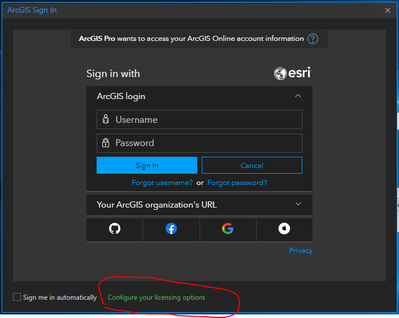

On your ArcGIS Pro login screen there should be an option "Configure your licensing options"
Once you click on that there is an option to change your License Type and if Single Use License is selected change the license level.
