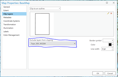

Ah I see now. The exclude layer is empty until you choose which layers to exclude. By default all layers are clipped. You have to manually select which layers you want to exclude from the exclude dropdown. In your picture you are looking at the clip type dropdown, not the exclude dropdown. In the exclude dropdown all the layers are listed and you can check them to exclude them. Once they are checked they'll appear in the dropdown list.

Just to confirm, after creating the series and selecting 'clip to index feature', when you go to the Map Properties -> Clip Layers, at the top it should say 'Clip to current map series index feature' and there should be an image of one of your 80 regions. Then drop down 'Exclude layers from clipping', all the map layers should be listed with tick boxes available. If the top section looks right but the drop down menu is blank then I'd say your version of Pro is not operating properly for you?

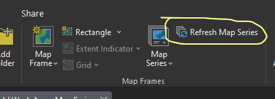

I think you were so close. Maybe what you're looking for is in the properties of the map view.
I have also noticed that if you don't see this change immediately after turning it on, go to the "Insert" tab and click the "Refresh Map Series" button.

Thanks for your feedback, this is great. Yes, Refresh Map Series is definitely an important step. 🙂 I was wondering how the clip in the map properties is different in the clip to extent when I do the Map Series. Can you please help me to understand what the three clip options in Map properties can do? Maybe there is  link/video you can share. Thank you!

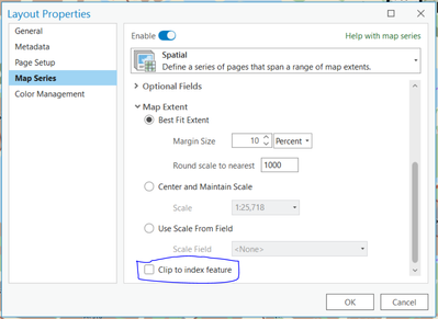

Page queries are great, but for your scenario I think you can simply check Clip to index feature under the Map Extent options for the map series. That will clip the everything outside of the index feature and make it disappear on the page. And it will update for each page. If there are layers you need to appear on every page you can exclude them from clipping in the map properties. I hope this helps!

You mentioned that I can exclude one layer in the map properties. I think this is exactly what I need.
I have all my vector layers in one map frame and I would like to see the imagery as a background. Ideally, in and outside the clipped polygon. Where in the map properties can I exclude this layer from clipping, please?
AubriOtis
All you need to do for that is exclude your imagery layer from the clipping. If you right click the map (not the map frame in the layout, the map itself, it's easy to mix them up) and choose Properties you'll open the Map Properties window. On the Clip Layers page you can choose one or more layers to exclude from clipping, including the basemap layers. Then when you go through the map series the vector data will be clipping but your raster or basemap layers won't be.

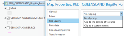

I start to believe I don't have the right version/release. My GUI looks different. I have an Advanced Licence and ArcGIS Pro 2.6.4
This is what I can see.
 I don't have "Clip to outline" and the "exclude layer" option.

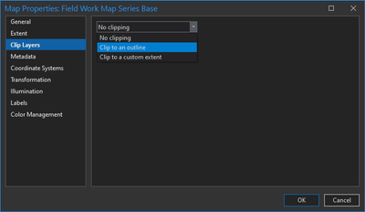

Great questions! Clip to outline is not available in the clipping dialog dropdown because it only applies to maps used in spatial map series. When you check "Clip to index features" on the map series dialog (the picture in my first response) then clip to outline will automatically be set as the clipping type and you can exclude the layers.
The map properties belong to the map, it doesn't matter if you access them in the map view or the layout view. The map frame properties are specific to the way a map is presented on the layout and are only accessible in layout views. As to the order you do things in, that depends on your preferences and workflows.
