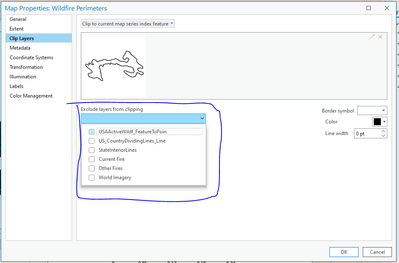

Yes, this is what I was trying to do. Problem is, when I  use the pulldown menu to select the layer I want to exclude for clipping (the imagery background layer, instead of a white background) I only get an empty list. No other layers are listed here.
Now my question. I use layer from the portal, meaning web maps and feature layers. I don't use feature class layers or shp files. Could this be the issues here? It seems to easy to just select this layer to be excluded, but for whatever reason the list is empty.

When I  use the pulldown menu to select the layer I want to exclude for clipping (the imagery background layer, instead of a white background) I only get an empty list. No other layers are listed here.
Here in the screenshot you can see that I have three options for clipping at the top and the layer I want to use for the spatial extent (map frame). The Exclude layer from clipping is empty.
This is the case in both approaches.
First approach start with the map, select clip to outline of feature - exclude is empty.
In the second approach where I go the the map series, specify my layer attributes for the extent, enable Clip within the Map Series dialog, go back the my map and then try to exclude the imagery/background layer.
Any idea why this is the case, please?
AubriOtis
Ah I see now. The exclude layer is empty until you choose which layers to exclude. By default all layers are clipped. You have to manually select which layers you want to exclude from the exclude dropdown. In your picture you are looking at the clip type dropdown, not the exclude dropdown. In the exclude dropdown all the layers are listed and you can check them to exclude them. Once they are checked they'll appear in the dropdown list.
