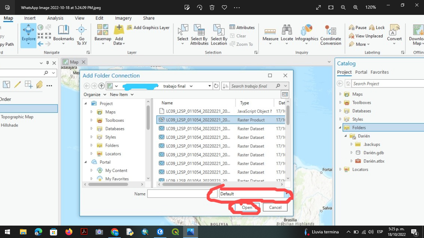

Hello,
I'm trying to add data to a new project of Arcgis Pro but it is not working. When I try the only option that appears is "open", instead of "ok" and the type of archive is always "default", I can't change it.
I don't know what to do, I really need this to work 😞
Thanks in advance

When adding a folder connection, the final selection should be the folder. In the photo provided you are selecting a raster dataset. You can't make a folder connection to a raster file.
Go up one level in the pop-up and connect to the folder containing the raster files.
This is standard for some spatial/drawing software. Helps with indexing and other aspects as the software is chatty with the folders you connect to. Best to remove folder connections you no longer need as the project grows.

I checked both Pro 3.0.2 and 2.9.3 and in both cases my Add Folder Connection window only shows the "Folders" option in the pull down you have outlined in red. I am not sure how data sources got listed.  Try going up levels BarryNorthey_0-1666150981310.png in the tree until you see the folder that you want to connect to.
Alternately, suggest that you Refresh the Folders connections in the Catalog pane and try again or restart Pro.
As a last resort, Open File Explorer and drag and drop the target folder onto Folders in the Catalog pane.

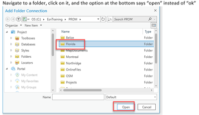

I am having the same issue but not when I am clicking a raster. I am trying to select a folder and am getting “open” instead of “ok.” Any ideas on what I should do? We can’t figure out why this is happening and have reinstalled. Every other computer in my unit works fine with an “ok” button but mine will only say “open.”

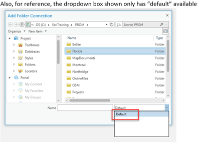

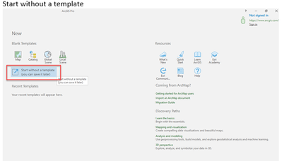

DonnaKattengell
Here is the process I am taking, maybe it will help you help me. 🙂
Any and all help is appreciated. This is driving us crazy.
