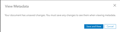

From a map in ArcGIS Pro, with the Share tab I share the fgdb feature class as a Weblayer to my AGOL account. In AGOL, I click on the item's metadata button and select 'view' and I'm given this window:

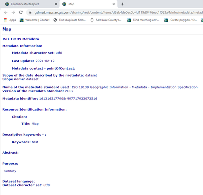

After clicking save and view, this is what is returned:
I then use the overwrite option and use the local xml that I created with the save as step.  Save and view then returns a bit more metadata in a browser window.
What exactly is the big white window that opens?  Is that considered a viewer or editor?  Depending on the the tab I select, certain items are on or off, but if I search long enough I can dig down deep enough to get to the contact info and attribute descriptions and other details that I expect to see.

Since what you published was the map, the portal item's metadata will reflect the metadata that you had on the Pro Map, and that's what you'll see when you click the big blue Metadata button. If you had only authored metadata for the feature class and not for the map, then there wouldn't have been any metadata to transfer to the portal item from the map.
The dialog that comes up is the ArcGIS Online metadata editor. You can change the metadata there if you want. Yes, you can upload the feature class metadata here if you want to copy it to the portal item. This would be roughly equivalent to the workflow you followed when you used ArcMap.
