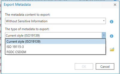

The export to xml options only provide three choices:

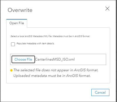

And when I then try to import  or overwrite the meta data in my AGOL item, I'm told:

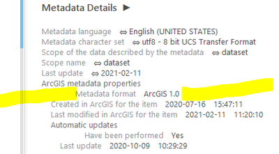

Funny you should mention that; the upgrade option is grayed out.  When I look at the Metadata Details in  a Catalog view it shows that it's 'upgraded' already:
One of the gazzillion help pages I looked at had me do a text search in the metadata display to look for that, and said in effect that if it says ArcGIS 1.0, it's upgraded....

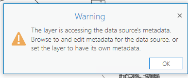

I've already created metadata in ArcGIS Pro, and editing an AGOL item's metadata in Pro does not sound appealing to me at all.  I get this message when I try to:
What does this mean exactly?

OK, the warning has to do with the layer's metadata setting. This is discussed in the View and edit metadata topic in the Pro help under the heading "A warning appears when you try to edit metadata". The layer can either have its own metadata or point to the data source's metadata. If the layer is pointing to the data source's metadata, then you have to directly access the data source in the Catalog view and edit its metadata from there. At the current time you can't shortcut accessing the data source from the map layer (the data source might not be directly accessible from the Catalog pane/view at all).
