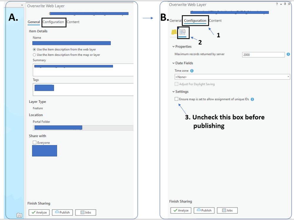

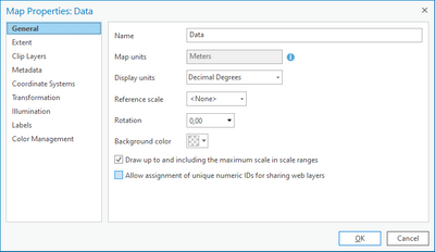

I had to fix the broken links and the going forward I made sure the following two settings/check boxes are unchecked every time before I overwrite my layers.
1. "Allow assignment of unique IDs for sharing web layers" under Map Properties. SO far I hav noticed that I only had to uncheck this ones and settings are saved on my future ArcGISPro instances, but the main other culprit that needs to be check always is the following
2. "Ensure map is set to allow assignment of unique IDs" - N.B to note that this found from a different location as show in image B below. In this image I sow steps I follow every time I want to overwrite a layer.

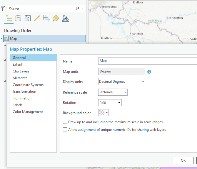

After you have published and you adding a new feature layer to your project, don't reorder the sequence of the layers if you have not enabled 'Allow assignment of unique IDs for sharing web layers' in the data frame properties.

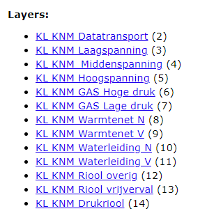

Each layer will get an unique sequence number when published like below (id)
If you have reordered the sequence in Pro without above settings the newly added layer will get an sequence id i.e. (2). Because you overwrite with publishing but the symbology keeps with the same id but the data behind it is then actually an other data layer.

In addition to @Stefan_Thorn's great reply, please see this help topic about assigning layer IDs: https://pro.arcgis.com/en/pro-app/latest/help/sharing/overview/assign-layer-ids.htm
Before overwriting a web feature layer, it's important to verify that the IDs assigned to layers and tables in your map match existing service sublayer IDs. Otherwise, overwriting may break web maps consuming the service. To fix this, you may have to republish layers and rebuild your web maps while paying special attention to the layer IDs you set.
