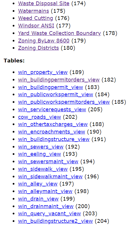

I need to add more feature classes to the project and republish, but it will not let me add layer under "underneath" or below the tables. the tables have rest end point layers id in the service too. My question is... how do I add a few more layers and NOT mess up the layer IDs of the tables when I republish?
I am not sure if this makes sense. Here is a snap shot of the rest end point layer IDs.:  as you can see...there is no real gap between the id numbers.

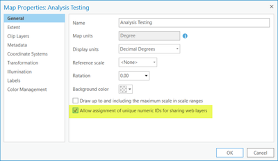

When you originally published this, did you have the "Allow assignment of unique numeric IDs for sharing web layers" options checked? This option, in the Map Properties dialog, lets you manually set the IDs of each of the layers so they aren't automatically generated and changed when layers are added.

@KenBuja's response was spot-on. Here is the help documentation: Assign layer IDs
Before overwriting web layers, please see this section: https://pro.arcgis.com/en/pro-app/latest/help/sharing/overview/overwrite-a-web-layer.htm#GUID-F229B4...
LarisaJohnstone
wow! I did not even know that was an option. I am so glad that you pointed that out to me....so I did not do that.
So basically if I don't check that off, I can assign the ID's myself?  With some reshuffling of workflow ids and a republish I think this will work.  one question...if I republish now and uncheck that option...will they stay the way they are if I don't change the order?
