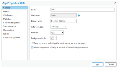

After you have published and you adding a new feature layer to your project, don't reorder the sequence of the layers if you have not enabled 'Allow assignment of unique IDs for sharing web layers' in the data frame properties.
Each layer will get an unique sequence number when publisched like below (id)
If you have reordered the sequence in Pro without above settings the newly added layer will get an sequence id i.e. (2). Because you overwrite with publishing but the symbology keeps with the same id but the data behind it is then actually an other data layer.

OMG I didn't even know this setting existed!! Thank you so much!
