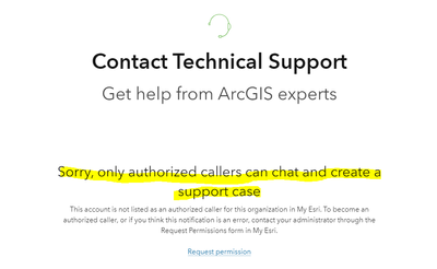

HannahAWhite
Ours had nothing to do with reclassify, but I will contact tech support and send them one of our APRX files with corrupt maps. Thank you for replying.
For more context, we work off of a local server in our company's office. It seems like the "map failed to open" errors usually occur after some time has passed. We reuse maps/layouts in reports from year to year, and often need to go back and update an APRX that hasn't been opened in 12 months.
HannahAWhite_0-1698863211226.png ???????
