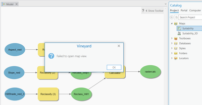

Hello everyone,
I have been working for 15 days on an important project. Every step/process that I was working on I saved it. When I open ArcGIS Pro (version 2.8) I found this message.
Please, could you help me in fixing this issue as soon as possible?
I'll highly appreciate your help.
Thank you.
