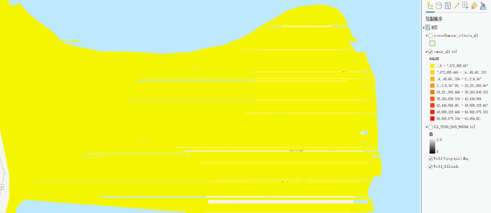

I want to cut .tiff by .shp and chose to use extract by mask. However, the result contains several white stripes as shown in picture. The value in these area are "Nodata", but the original .tiff does have values in these area. I would like to ask how could I solve this problem. Thanks in advance.EBM problem.png
Tags (1)
DanPatterson
MVP Esteemed Contributor
the shape file has issues then if it has those stripes, get the shapefile into edit mode and remove any spurious vertices that are in the interior

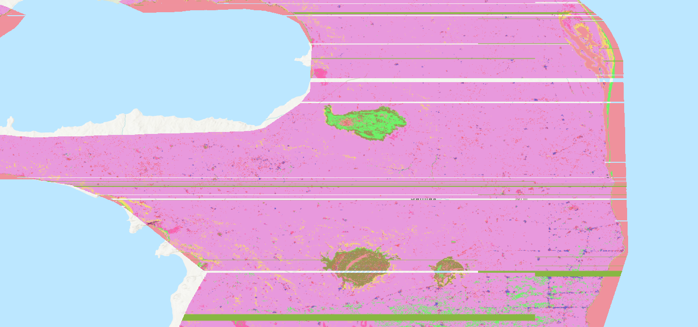

When I converted .shp into .gdb and used Extract by Mask, the white stripes become even more.
When I only converted .shp into .tif without Extract by Mask, as shown in the picture, the .tif itself has included white stripes.
DanPatterson
