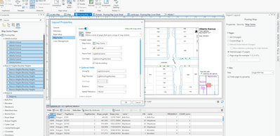

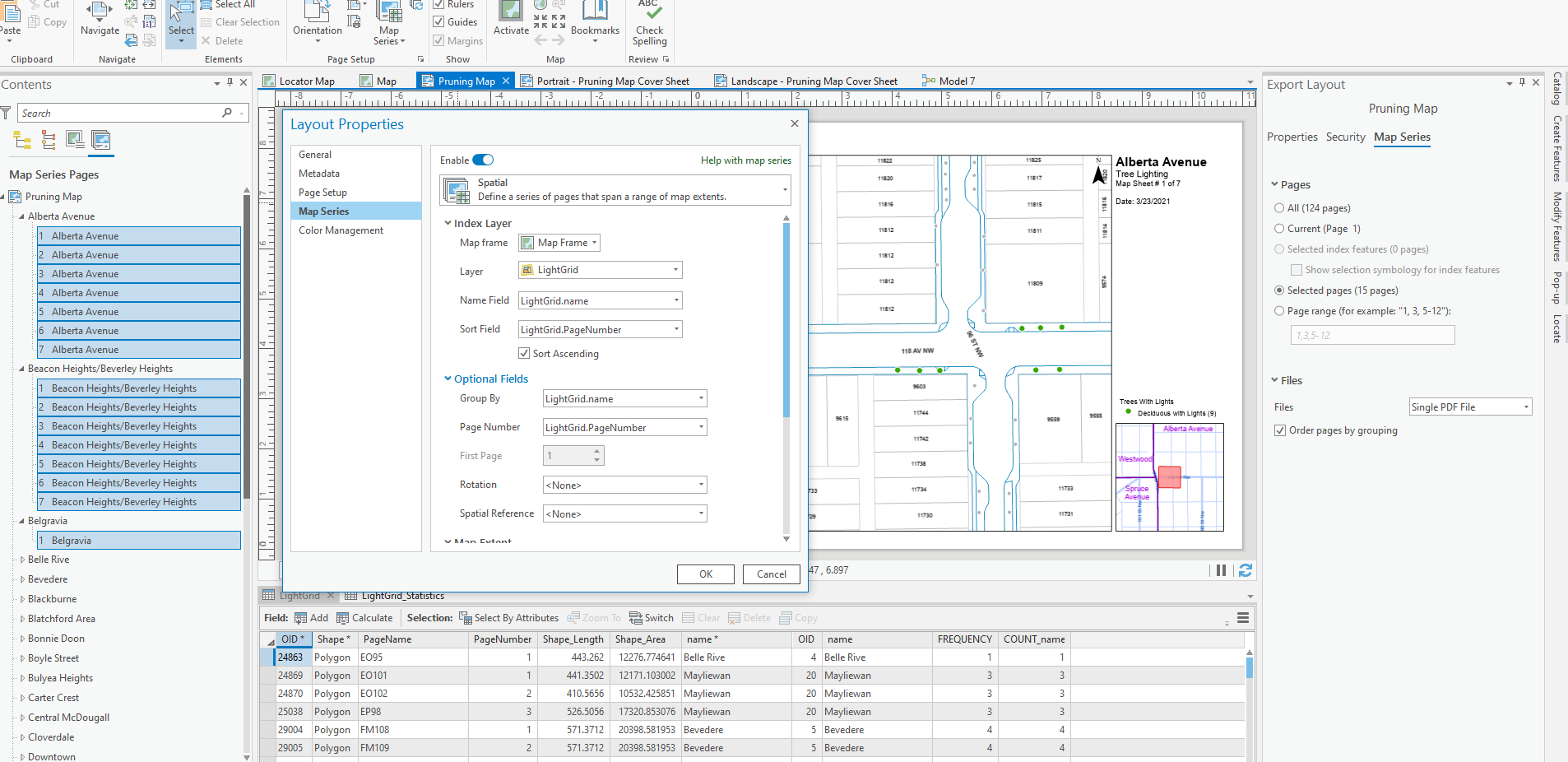

In ArcGIS Pro 2.6.1, I have created a map series of pruning maps. The map series is grouped by neighbourhood name. One neighbourhood might have 9 pruning maps and one might have 2. I would like to export the pruning maps so that each neighbourhood exports as a single PDF. Is there a way to export by the group as a single .pdf and still take advantage of the 'page name as suffix' naming option.
In the example shown above, I'd like Alberta Avenue to export as a .pdf with 7 pages, Beacon Heights/Beverley Heights to export as a .pdf with 7 pages and Belgravia to export as a .pdf with only the one page. I can export each neighbourhood as a .pdf manually, but I have 400 neighborhoods and it is slow going. Any help would be appreciated. Thank you!

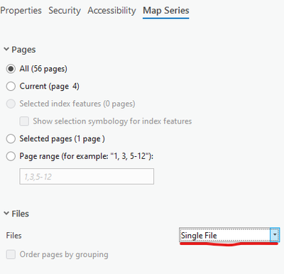

kikn
This can be done in the Export Layout pane. Under Map Series tab, under Files > Single File  (drop down).
