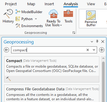

ChrisUnderwood
Hello @EaswarA The Compact tool is in the ArcGIS Pro Toolbox, you can just search for it.
If that does not help, please provide some details about what you are doing, and what you are seeing, to lead you to believe you are seeing some Locking problems.
EaswarA
Hi @ChrisUnderwood
Thanks for sharing the screenshot. Tried to run the compact , but It doesn't help in removing lock.
It runs only compact process.
