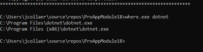

Thanks to command (console from visual studio) where.exe dotnet I was able to check that my x86 dotnet was listed first and as my computer was 64 architecture I had to edit path environment valriable to put the 64 dotnet BEFORE the x86 dotnet (and reboot to take effect).
When locating dotnet if you computer is a 64 you should see this correct order:
