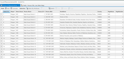

For my project, I need a map series for the Legislative Districts in Hawaii. Loaded the House District feature class into ArcPro, opened the attribute table details and added two columns: PageName (Text) and PageNumber (Double), then field calculated the numbers/names:
Under Analysis Tools, I built a Spatial Index for the House District feature class (which I'm not sure it was necessary, but I'm just a hack so will do anything to make it work shhh).

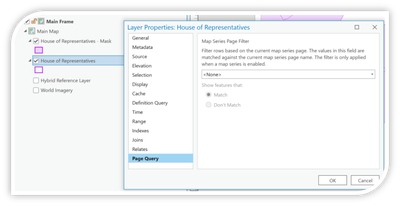

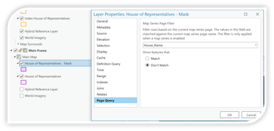

To create the mask, copy the same layer in the TOC and label one as “mask” then open layer properties > page query, according to the attribute you desire (I want to mask out the districts not the focus of the layout) select “don’t match".
For the layer you want to show, select None, and put it underneath the mask layer in the TOC.
This is the output, the district I want to see with the surrounding districts "masked" out:
