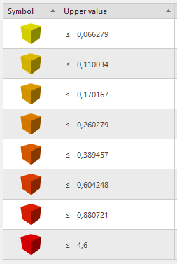

I am trying to change symbology of 3D layer using  arcpy. The final symbology, that I am trying to create is supposed to be Graduated colors with the Centered Cube symbol (e.g. picture bellow). I am using 'GraduatedColorsRenderer' and I am changing the symbol for each class (the symbol is same for each class). I am using  'applySymbolFromGallery' method to change the symbol. The issue is that if I fill in some 3D symbol in this method the symbology is not applied. There is no error and the symbology is changed in content pane and also in symbology pane, but the symbols in Scene are not displayed.  If I use any 2D symbol, everything works just fine. (If i set the 3D symbol in GUI it also works)
