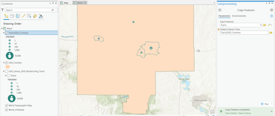

After Selecting the Tracts based on your county boundary/attribute,
Use Copy Features or Feature Class to Feature Class tool.
Think Location
VMitch
The above worked well for me
