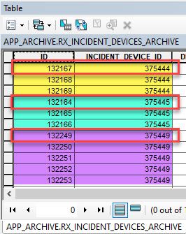

I have a similar issue.  I have several records per Incident Device ID and only want the first (numerical order) device per Incident ID.
In the image attached, I have 3 incident device numbers (375444, 375445, and 375449).  I want to select the first record of these using the ID field.  I have no idea how to structure this query.  Any help is greatly appreciated!

@LauraGiboo, as I mention in an earlier comment, the SQL that is supported with the Select By ... tools varies depending on back-end data store. What is the back-end data store, file geodatabase?
LauraGiboo
It is an enterprise geodatabase (oracle).
