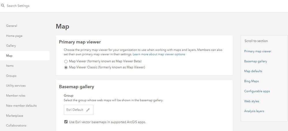

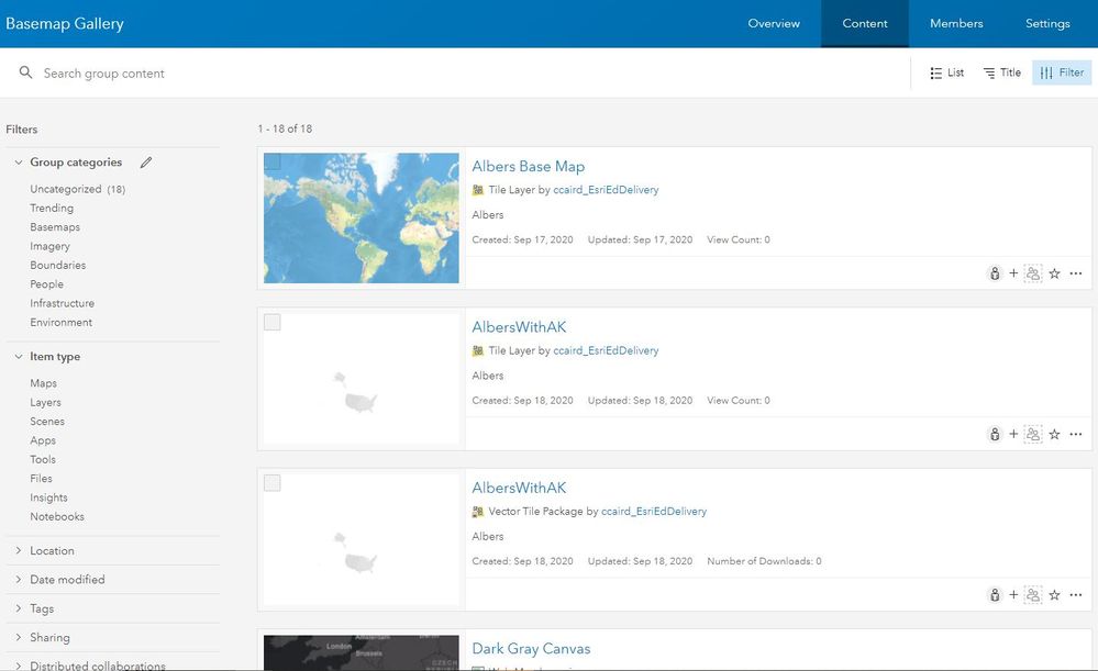

By chance are you using a different logins to ArcGIS Online in ArcGIS Pro?
Typically, the basemap gallery items are determined by one's ArcGIS Online administrator.  See the images below and are set in Esri Default.

@Robert_LeClair  No, I use the same login for both. I'm an admin though, where can I find those settings?
VMitch
by
Regular Contributor
The above are in the 'settings' of your ArcGIS Online account.
