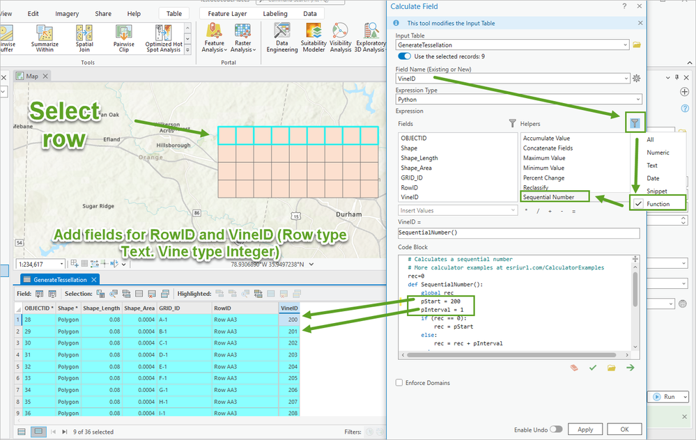

To get the Row and Vine IDs, I'd suggest adding two fields to your cells - RowID (probably use a text field) and VineID (use an integer field).  For each row, select the features in that row, and in the field calculator, calculate the RowID to be the row name string. Then calculate the VineID field. Use the "Sequential Number" helper function. In the code block, choose the starting vineID number (e.g. 200 and the increment value (probably 1). Run the calculation.
