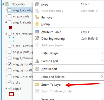

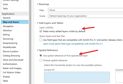

by default, maps are assigned the coordinate system of the first layer added to the map (from project backstage)
you should also be able to right-click on the layer and "zoom to layer"
what are your settings?
and what if you don't use a basemap, can you add a featureclass and it shows properly?
