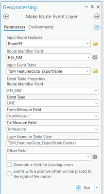

I think your input data is already set up to be used directly. So try this:
Convert your point feature class to a table using the Export table tool and write to a table called TSM_FeaturesOutp_ExportTable and then use the Make Route Event Layer to create your lines as follows:
Hope this is the output you are looking for.

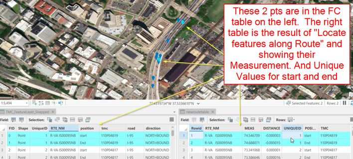

OK so I have a linear referenced road feature that has M values. I can identify to see those distance along the line
I have a Feature Class with XY of start and End....I am not sure where to go from here....
Do I have to go into the point FC and create a new field to identify the road segment the point is on?
Not sure cause I do not have distance along a road for those points I only have the XY
kapalczynski
@AyanPalit  OK so I took my point Feature Class with the XY values and ran it against the Roads with M values (Locate Features Along Route) and I ended up with a Table that has the point locations and a new field called MEAS which seems to get the distance the point location is along the road...
Now I want to select the road segment that falls between 2 specific points and right that to a new Line Feature Class.  Noting that there can be overlaps between the other point sets...
I think I am doing this correct?

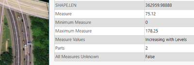

OK @AyanPalit and @JaySandhu now I'm confused even more... I know there are a ton of ways to approach problems as I am being told two ways here...
  • I attached my Point Feature Class that has to fields at the end 'ToMeasure' and 'FromMeasur'
  • I attached a road segment with M values.
  • RTE_NM was used for the 'Locate Features Along Route'
What would be the best solution to get an output of 580 line features that correspond to the records in the Point FC 'ToMeasure' and 'FromMeasur' Fields.
I am looking to get 580 road segments that mirror the Route FC that are between each of the 580 Locations per the Measure fields.
Really Appreciate your help with this.

Looks like you need a linear referencing solution and NOT a routing solution.
You need to turn your Route95 line features into linearly referenced routes with appropriate calibrations. Then your point features with the start and end measures are really an Event table with linear events based on these linearly referenced routes.
For example, the first point, has a route name: R-VA IS00095NB and From Measure: 89.618 and To Measure 91.943
To return back a line feature between these two measure values for multiple records, you can use the Locate Feature Along Route tool. But for that to work, you need to provide the Route95 set up as linearly referenced routes with that measure units so positions like 89.618 to 91.943 can be figured out.
Locate Features Along Routes (Linear Referencing)—ArcGIS Pro | Documentation
You can use the Create Routes tool to turn the Route95 lines into appropriate routes. But I am not sure what measure values to use to calibrate them for your measure values. Tool info:
Create Routes (Linear Referencing)—ArcGIS Pro | Documentation
