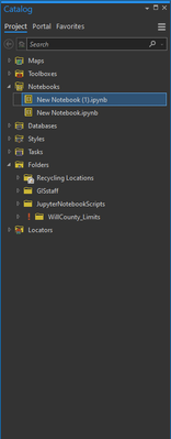

So, I create a notebook in arcgis pro 2.5.2, open the catalog pane, click the notebook and ...
why is it a problem to open a notebook from a unc path?
I can't imagine I'm the first to run into this, could not find it here though, anyone who knows a way out of this?

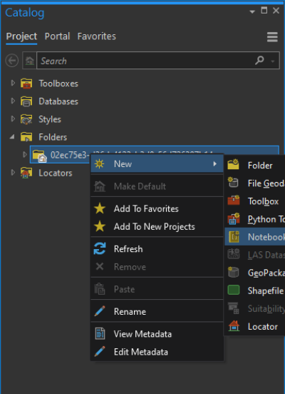

I'm using Pro 2.6.0 and this problem still exists. In the catalog, when I attempt to add a New Notebook I get the same error. It does get created, but it won't load.
Just giving you a heads-up. I ended up creating a Notebook from Folders in the catalog. I have a connection to a folder in my C drive.

I have just ran into this problem myself. I am new to Notebooks but wanted to try it in Pro, then I ran into the error and found this thread. I noticed you said you got it to work by creating the Notebook within the Folder within the catalog pane. When I try to do this I get the same error? Did you literally just right click within a folder and create notebook?

That's what I did. I right clicked within the catalog window.
