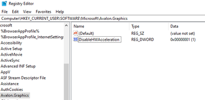

Has this REALLY been an issue since version 2.6?   we're at 2.7.2 now and the only permanent fix is to 'disable hardware acceleration' in the registry??
Come on, man!!
UPDATED Hardware REPORT/REQUEST:   My Lenovo Yoga was built with: Intel(R) Iris(R) Xe Graphics  too...
MY SOLUTION:
the REGISTRY EDIT solution worked for me: Disabled HW Acceleration (Until a permanent fix from Intel)

There is a problem with WPF Hardware Acceleration and the Web Browser Component (CEFSharp) used by ArcGIS pro. The only way that I found to resolve this issue is to temporary disable WPF Acceleration https://docs.microsoft.com/en-us/dotnet/desktop/wpf/graphics-multimedia/graphics-rendering-registry-...

Thanks also to @AgostinoCirasa_sitr . I can confirm that your registry solution works, at least for the Explore tool. I haven't needed to log in again since. Though I'm not sure this is something your users should be required to do ESRI

I wasn't keen on disabling hardware acceleration as I wasn't sure what the wider implications would be, so I wrote a python script to toggle the hardware acceleration off, start ArcGIS Pro, then wait a few seconds for it to read the registry, then toggle it back on. As the registry is only read at startup, it only affects ArcGIS.
Thereafter, all dialogs seem to be working (so far)

Looks like the issue has to do with hardware acceleration.
Ersi has a solution here: https://support.esri.com/en/Technical-Article/000025347
Tip, you'll have to do some registry edits to fix.
