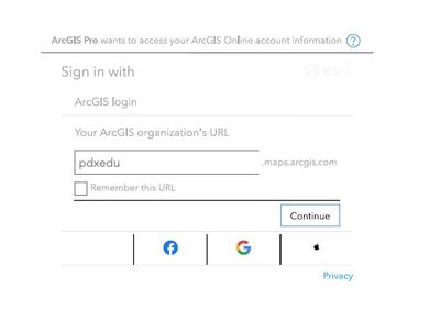

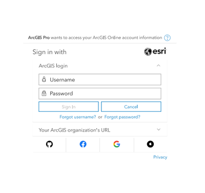

Alvaqui
New Contributor
Hi, what you have to do is right-click on the empty screen and select "print", then save it as a pdf. The following is the first screenshot from the empty Sign In page:
Using a second monitor I was able to get some information but still a non-responsive page, but it was helpful to use as a reference guide. The fill in boxes won't necessarily be in the same place, for example for me, to select "Your ArcGIS organization's URL" I found it close to where "Forgot password" is:
I right-clicked on that page, selected print and saved it as pdf, and got this:
Next print:
Then you have to copy-paste the information as Yunmei explained, but you won't see any changes in that window, that's why you would need to keep printing the page to see if you are pasting the information in the right place and keep going.

And so on...
Hope this help 🙂 and apparently, this is currently the only solution, even my ArcGIS professor recommended it to me. You are the best Yunmei!!!
