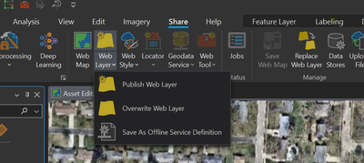

Hi, I'm new to ArcGIS Pro (using 3.2 Pro) and trying to understand the best workflow to update AGOL web maps through ArcGIS Pro.  Basically just testing what I can/can't do at this point.
This has been posted a few times, but with some conflicting responses.
After making a map, sharing it to AGOL, and then re-opening the web map from the portal in ArcGIS Pro, I tried adding a new shapefile to the map and then re-saving it (Share > Save Web Map > Save).  I get the error pop-up described in this post ("[web layer] already exist, please choose a different name..."), with a solution to go online, delete the old layer, and try again.  Same solution offered here.
But another thread on desktop / AGOL workflows linked to this part of the What's New in ArcGIS Pro 2.6.  The narrator can be seen adding a new layer to an existing web map and then saving it without the issue.
It would be great to be able to do what's in the 2.6 video, but I can't seem to replicate it in my later version.  Am I missing a step or is this not actually possible (anymore)?
I also found this post with a workaround, but it also says you can't make changes to symbology in the layer, but that same video above specifically says you can.

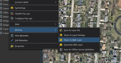

You can overwrite Web Layers (Hosted Feature Layers) from pro. It sounds like you are trying to overwrite webmaps. I personally haven't tried that.
Sharing Layers to AGOL and hosting them to AGOL has proven to be a really good workflow for myself.
To share a specific layer or a group layer, you would highlight the layer(s) in your contents pane (arrange them in the order you want them), right click, click sharing then share as Web Layer. Once you have an existing Web Layer in AGOL you can go through this same process and choose the "Overwrite Web Layer". Sharing this way only works by right clicking the layer.
I actually spoke with someone from ESRI couple weeks ago about this.
If you share from the top tab, you will share all of your contents in the map you are currently using in ArcGIS Pro. This functionality is intentional and doesn't plan to be changed anytime in the near future.

Nick_Creedon
Correct, I am building the maps in AGOL after the layer is already shared as a Web Layer. Yes, when creating a webmap you can add and remove layers independently.
