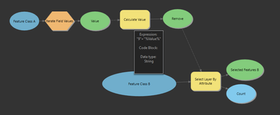

I have a similar situation and what appears to be incorrect result.  My model iterates field values on feature class A. In the same model I have select by attributes on feature class B.  I used the Calculate Value tool to create an additional variable, that simply adds a 9 to the front of the Value variable.  My expression is
field LIKE %Value% AND field NOT LIKE %Remove% (I have to remove 5 digit values beginning with 9 from the selection from their similar 4 digit values without the leading 9).  When I "manually" create this expression, it works.  When I try to run with the iterator, it ignores the "remove" logic and selects more features than to be expected.
