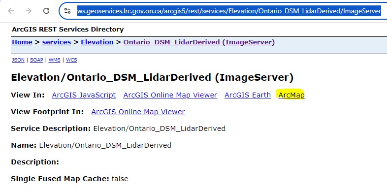

I've brought this raster data into Pro by clicking the ArcMap link to download a .LYR file.
https://ws.geoservices.lrc.gov.on.ca/arcgis5/rest/services/Elevation/Ontario_DSM_LidarDerived/ImageS...

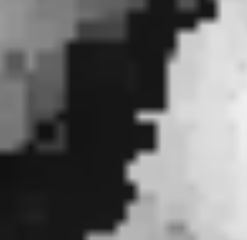

But when I export my subject area using Clip Raster or Export Raster, the pixels are blurry (DRA is used here as well).
Why are the pixels blurry in the raster export?

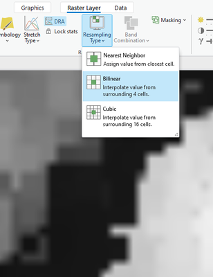

I noticed that the Resampling Type was set to Nearest Neighbor in the source data.
But in the exported raster, the default Resampling Type was set to Bilinear.
So, I changed the Resampling Type in the export to Nearest Neighbor. That made the pixels less blurry.
