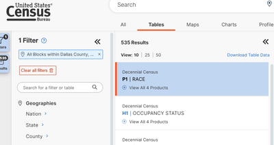

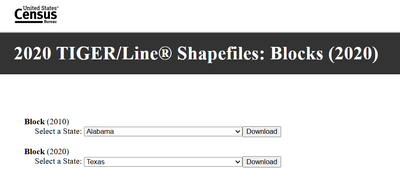

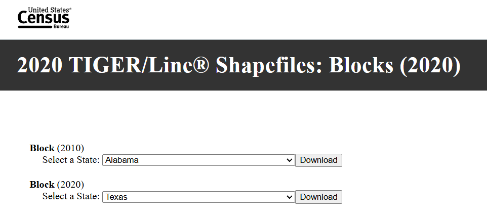

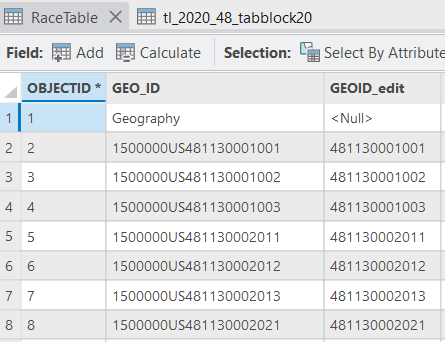

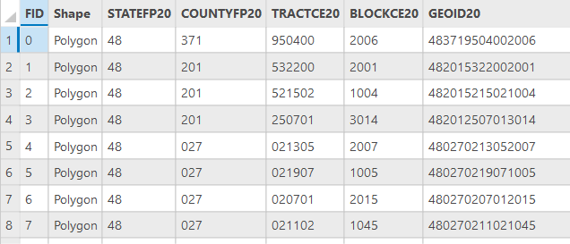

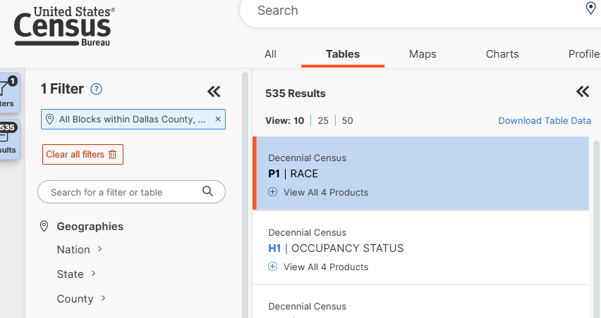

I'm trying to join a census block shapefile, taken from here, with a census data table found here. The problem is the attribute tables don't align, in particular their GEOIDs. I've got no idea what to do, is it a problem with my data sources? Pictured below are the two hyperlinks, as well as the attribute tables from my two sources of data.

If there's no common field to match to or a logical way to create a common field e.g.
table 1 - GEOID000567
table 2 - 567
-> Create new calculated field for table 2 and then match against -> 'GEOID000' + [table2]
Other than manually adding a matching attribute then joining - you'll need to find a new polygon data source.  I would imagine there's many alternatives.
