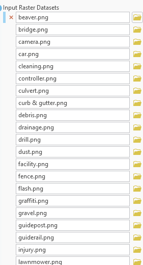

Second best thing to picking the folder: pop the folder open, click the first raster, scroll to the bottom, shift-click the last raster. Or click one raster then hit Ctrl+A if you're 100% sure every file in there is a raster dataset.

I'm testing on Pro 3.4 and I'm not having any issues bulk selecting rasters (See screenshots). That said I don't have proper imagery on hand so maybe you're getting an error running the tool?

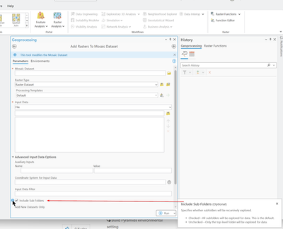

I've seen what you are asking for in the add rasters to mosaic dataset tool
the list by details and show full path options are useful for me
too
https://pro.arcgis.com/en/pro-app/latest/tool-reference/data-management/add-rasters-to-mosaic-datase...
