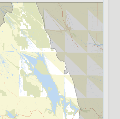

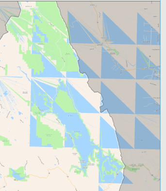

Does anyone know what might cause basemaps in ArcGIS Pro not to render completely? Depending on how far I zoom in or out on my map, weird lines and triangles start to appear on the basemap. Below are two screenshot of what this looks like using two different basemaps.
Navigation basemap:
Steets basemap:

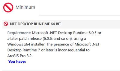

Below are the results I got from running the system requirements check you provided for ArcGIS Pro 3.2. I'm not sure if it's the same requirements for the older 2.3 version I'm running.

I would certainly recommend upgrading to either the latest version of ArcGIS Pro or to the last versions of ArcGIS 2.9.11 to ensure that you will be supported and also to see if this issue occurs at a newer version.
If you want to run v3.x.x I would recommend fulfilling the requirements missing or that have not met the system checker. https://pro.arcgis.com/en/pro-app/latest/get-started/arcgis-pro-system-requirements.htm
