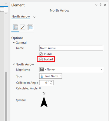

Tim, I would guess that these items are locked.
When you lock them in the options tab of the element pane then they are no longer selectable via the select tool (as this gives access to resizing, moving etc.). Once they are locked they can only be accessed by highlighting the element in the contents.
To check, right-click an element in your contents pane and choose properties from the dropdown menu.

RichardHowe

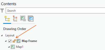

RichardHowe
Tim,
Glad that helped. The padlock icon you see at the top of contents pane is another option. If all your elements were in one group then you could inadvertently lock them all by clicking that...or ctrl+L key when it was highlighted
