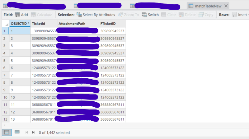

Hello Everyone, I am facing very weird issue while using Add Attachments Tool in ArcPRO. This is after I updated to the latest version.
I have created a table based on which I have 4 fields as you can see below and based on 'Ticketid' column I am attaching the attachments to the feature class. After selecting the table, if I go to 'Match Join Field' the 'Ticketid' column is not coming up for selection. (Please refer to the below images)
The 'Ticketid' data type is bigint. Earlier it was working fine but after update, it's acting weird. I am doing the same thing using arcpy script too but having same issue.

This is a bug. I hope ESRI recognize it and solve it in the next release. Though for time being, I have resolved the issue by forcing column type to integer.
