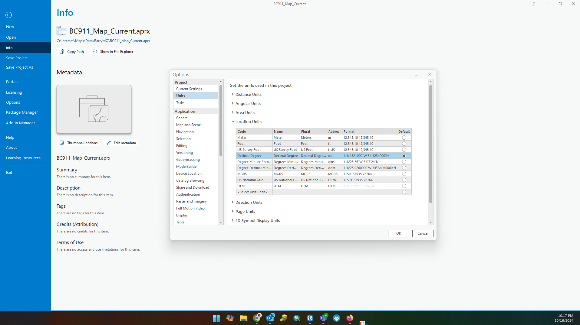

Is there a way to auto populate Lat / Long coordinates in decimal degrees in ArcGIS Pro?  We have deployed ESRI's Address Data Management solution and use that to assign and maintain our address points and road centerlines.  In the attribute rules, I have added one to try and populate the coordinates but it will not auto populate in the decimal degree format.  The map project shows the decimal degree is set to default, the map itself uses the format when working on the map, it will let me manually get the decimal degree format, but it will not go to that format automatically.  I have attached some pictures of what is going on.

Okay, fair enough.  Have you tried changing the Fields View "Number Format" such that the value represents Decimal Degrees?

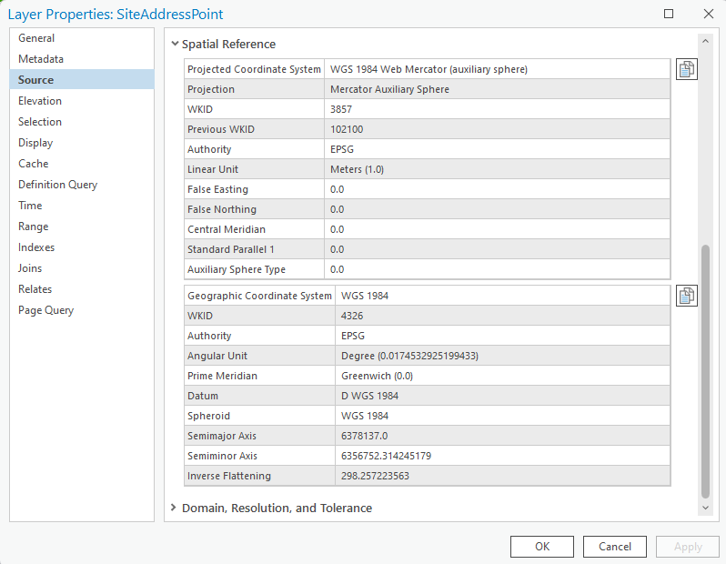

I think it would be helpful to know the units of the X and Y coordinates. i.e. projected coordinate system or geographic system...  Feet, meters, degrees?
You need to know the projected coordinate system (PCS) from which your data comes. This might be something like UTM (Universal Transverse Mercator), State Plane Coordinate System (SPCS), or another projection.
CameronKoehler
I believe this is the information you are asking about.  Attached is the Spatial Reference from the point data.
