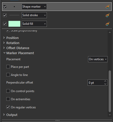

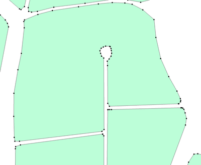

Riffing on @dandandan's suggestion, it occurs to me that you could also do this with symbology.
Just add a Marker Layer to your reference polygon's symbology, and set the Marker Placement settings to "On vertices" and turn off "Angle to line".
I used the square from the top of the ESRI Default Marker font; Unicode 34.
This way, you won't have to re-run Feature Vertices to Points any time your reference layer changes.
As for your layer snapping to itself when the points are close, you can actually turn that off from the contents pane.  Click the snapping tab, and uncheck the new layer you're adjusting.  That way, it'll still snap to the reference layer, but you won't keep getting hung up on the edited layer.
