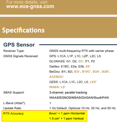

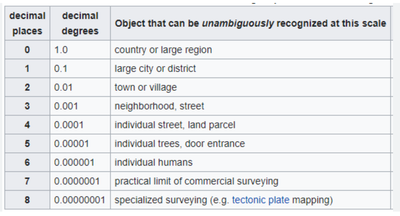

hi Cameron,
can you share these details with your board? GPS metadata such as Lat/Long is baked in as double
ArcGIS Pro 3.3 >
Add GPS Metadata Fields (Data Management)
https://pro.arcgis.com/en/pro-app/latest/tool-reference/data-management/add-gps-metadata-fields.htm
ArcGIS field data types
https://pro.arcgis.com/en/pro-app/latest/help/data/geodatabases/overview/arcgis-field-data-types.htm...
Examples:
