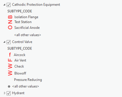

does anyone know why the symbol of my layers turn to a letters instead?
I will appreciate you feedback.
Thanks all

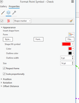

My guess is the symbols were originally based on a custom font that is no longer available, and Pro is defaulting to the same character in whatever the default font is in your settings.
If you could provide more information and maybe a screenshot from the Symbology pane, that would be helpful in figuring out what's going on.

And can you go into the actual symbology pane for one of the symbols and see what its settings are? Is it a Font marker?

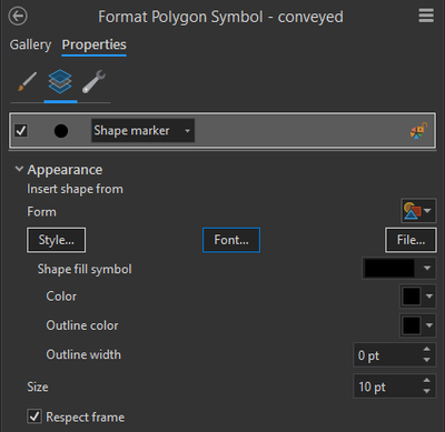

And now click "Font"?
