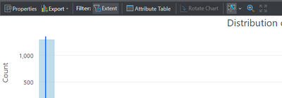

DanPatterson_Retired
MVP Emeritus
Filter, Selection
44 Replies
MVP Emeritus
Filter, Selection
JoeBorgione
MVP Emeritus
Cool.  A little hidden, but it's there:

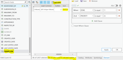

Once you have your selection, you can use ctrl + shift + D to open the data engineering window. On the left side of the pane click and drag the field that you are interested in into the middle and then click the Calculate button. (In my case, I'm interested in the SUM of the length fields). Make sure to click the calculate button every time you make a new selection.
TierneyRosenstock
The ctrl +shift+D didn't work for me, but I was able to open the data engineering window from the data tab in the ribbon. This gets me the statistics I need, so thank you(!), but it doesn't answer why filer by selection isn't an option in my chart window.

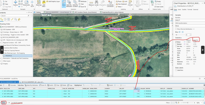

Sharing for posterity.  I had this same question except I wanted the sum of the selected records, not the mean, so the solution given above didn't help.  Turns out all I needed to do was widen the Chart Properties pane.  Statistics for the selection are to the right of the statistics for the dataset.
Showing that the statistics for a selection are to the right of the statistics for the whole dataset in the Chart Properties pane.
