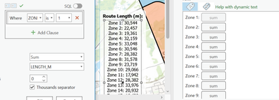

I found a way to add it to my layout by including SQL queries in my dynamic text box. The zones/routes change from year to year so this option is way more straight forward in my opinion - no need to manually copy & paste the values from the Data Engineering pane. This option works well for this example but I was working on a project the other day that has some layers that were created using the create layer from selected features option and unfortunately dynamic text wasn't behaving as expected in that case.
StephenJackson1
Very nice!  SQL is my next language to learn...so I've not scratched the surface (yet) of what can be done with this program.  Thank you for sharing your success with SQL queries, I like the fact that it's dynamic text.

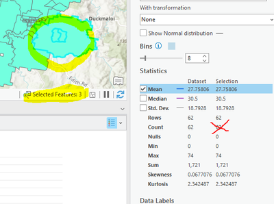

Michael_Kraus
There also seems to be a bug (I am using ArcGIS Pro 3.1) where if you create a layer using "Make Layer from Selected Features" the stats don't show for a further selection on this selection layer.
