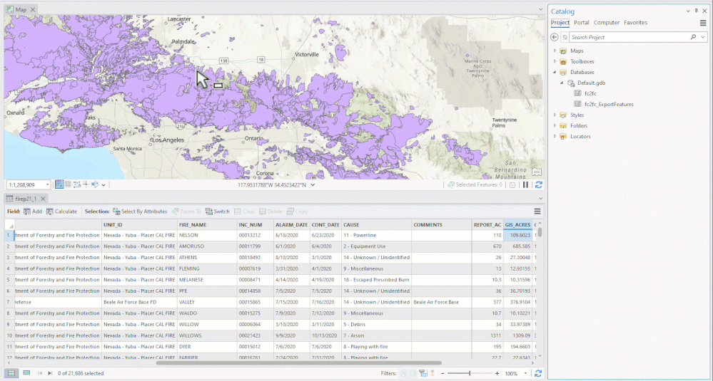

With a selection in place, when you click Statistics for a field in ArcGIS Pro, you get the statistics both for the selection and for all features:
 Is there something specific that isn't working for you? If you do have an idea, feel free to search the Pro ideas to see if it already exists, vote and add a comment with details about your use case. If one does not exist, you can add one - follow the ArcGIS Ideas Submission Guidelines and Statuses
