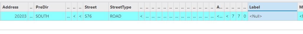

Hello everyone,
I am needing some assistance with writing a concatenation. I have a "label" attribute field that is currently "null".
I need to concatenate the fields from other columns into the "label" column.
Individual Columns:
Address
Pre-directional
Street
Street Type
I need to concatenate these individual columns to read as a full address in the "label" column.

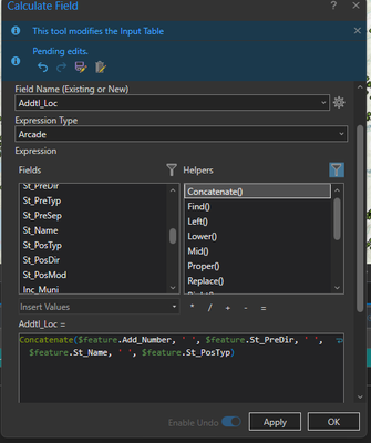

JasonBagwell1
Where you would calculate using your field names.
Concatenate($feature.Address, ' ', $feature.PreDirectional, ' ', $feature.Street, ' ', $feature.St_Type)

JasonBagwell1
The error could be caused by concatenating a string with an integer.
JasonBagwell1
