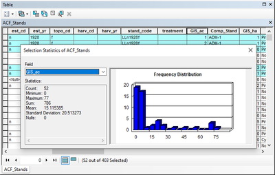

Thank you for the additional information.  In ArcMap, I typically apply the Selection Statistics tool (to an active selection of roads) to calculate a sum of road lengths.  I wanted a quick and easy tool to perform the same task in ArcGIS Pro.  The Summary Statistics tool (in Pro) is too cumbersome for this task, adds too many steps to be "quick and easy".  One of the contributors to this forum mentioned using the Data Engineering selection tool, which after a couple of uses has become my quick and easy solution to calculate sums from an active selection (without generating an unnecessary chart).  Using the Data Engineering selection tool works well however it does add a couple of extra mouse clicks compared to the ArcMap Selection Statistics tool AND users must "refresh" (manually select the "calculate" button) after each new set of active selections.
DavidFox
I agree that the old ArcMap table Statistics (Right-click a numeric field --> Statistics) was quicker and more intuitive. I'd like that function back rather than having a chart saved in the project (that I just have to delete).
