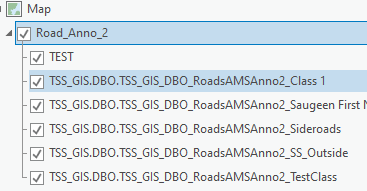

I'm having an issue with my annotation classes, I have multiple classes in one layer, so that I can turn on/off specific classes depending on my needs. The problem I'm running into is that I'm unable to rename the classes permanently. I used append annotation feature classes to fix a different issue, but now the class names are all extra long (ex. RoadsAMSAnno2_Sideroads) instead of the original name (ex. Sideroads). The anno is not feature linked.
I know that I can change the name in the contents page, but does anyone know how to change the names permanently so that when I pull the layer into a new map I don't have to change the names again?

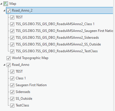

This works for the layer name, the issue I'm having is related to the class names. I've attached a screenshot to show what I mean. The Road_Anno_2 layer is what the class names appear as when newly pulled into a map, the Road_Anno layer is what I would like them to say (although I'll remove the test classes later). There is no option in the class properties that I can see, I've attached a second screenshot to show the properties for an individual class.

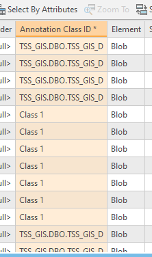

This does rename the classes in the attribute table, but it doesn't appear to change the names in the content pane.

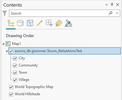

My anno workflow is a bit different than yours as I'm using a fGDB vs. an eGDB.  But I did make a database connection from ArcGIS Pro and copy/pasted the annotation feaure class from the fGDB to the eGDB and the result was not having the database.owner.table syntax that you're seeing.  See the image below.

I couldn't figure a way out (using a FGDB to store annotation) to rename an annotation class either. Like you, if I renamed the subtypes the annotation class name stayed the same in the Annotation Feature Class Properties. I resorted to creating a new annotation class with the same properties and naming it how I liked. Then I had to select all the annotations using that class, change their Annotation Class ID using the Attributes pane, and change their Symbol class to match under the Annotation tab in Attributes.
