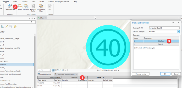

VogtBoat
I was able to rename the subtype just fine using the "Change/Manage" Subtypes pane.
