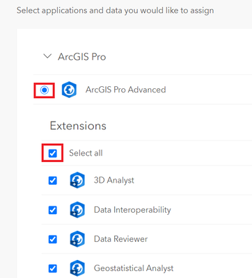

Setup your organization on AGOL, as desired. Once done, go to Oranization > Members. Click on the "..." > Manage Add-on licenses.
Select ArcGIS Pro Advanced, followed by "Select All" under Extensions. Save.
