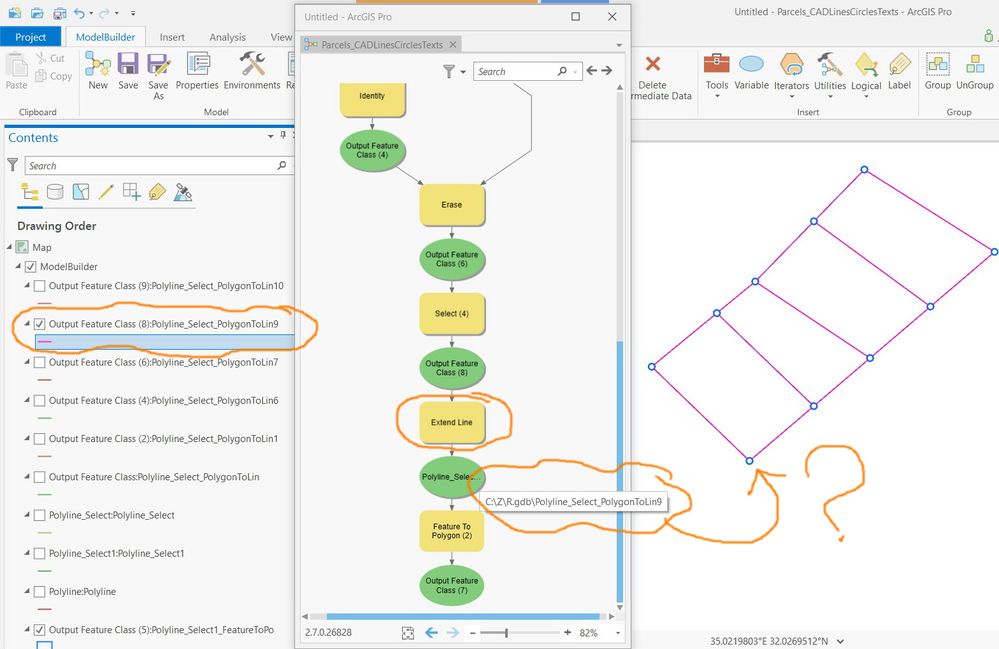

I couldn’t figure out why “extend” tool fails to extend particular lines.
What could be the issue here?
Sample data is attached

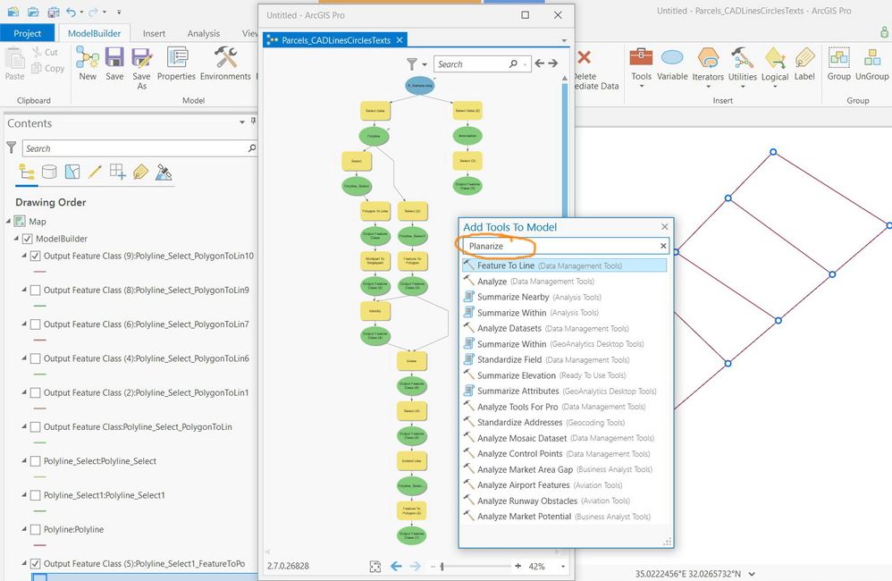

If in fact there are overlapping lines in your data, you may want to run the Planarize command first to see if that resolves some of your errors you're seeing in the data, then run the Extend Lines GP tool.  What is the result?

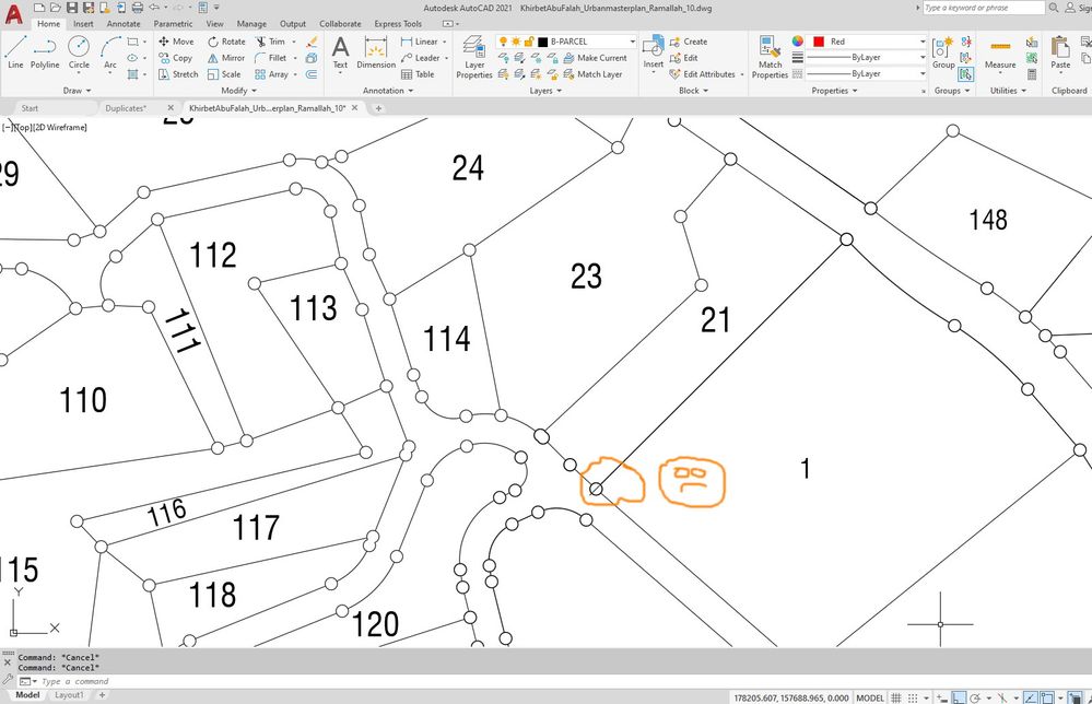

As raw CAD data comes with circles, lines, and text out of which parcels are assumed to be derived. The following approach is followed
  • All lines inside circles are erased (to clean them)

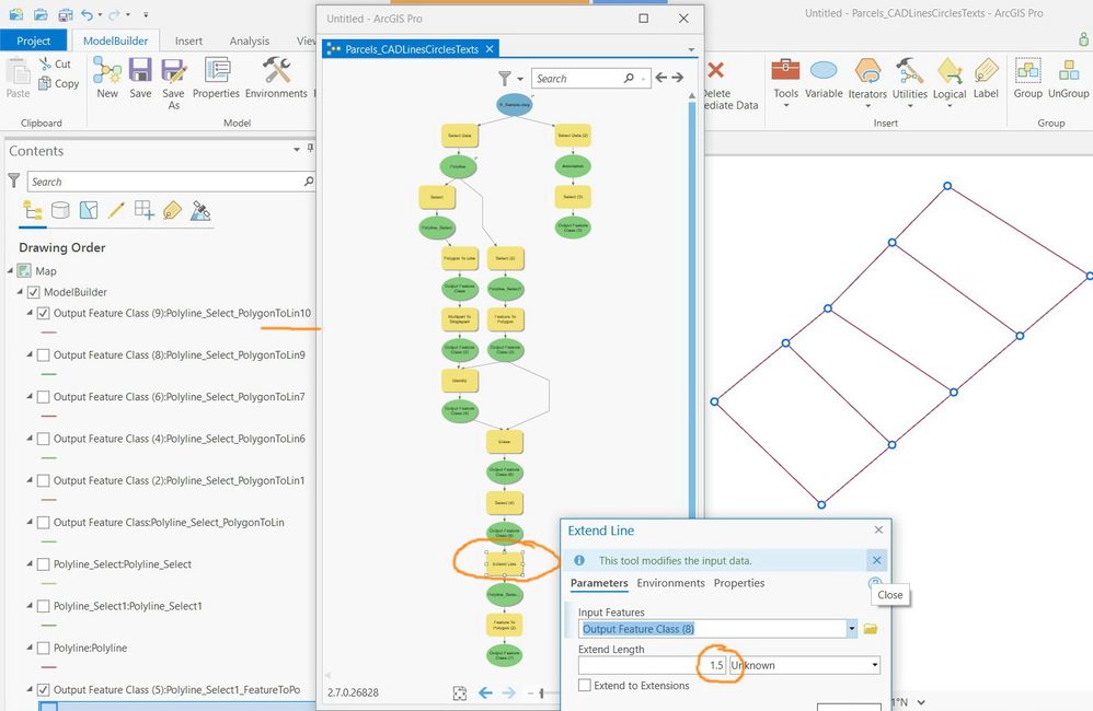

  • Lines are extended by 1.5 (I assume that lines will extend from each end by 0.75)
  • Lines are converted to polygons
  • Texts are transferred to polygons

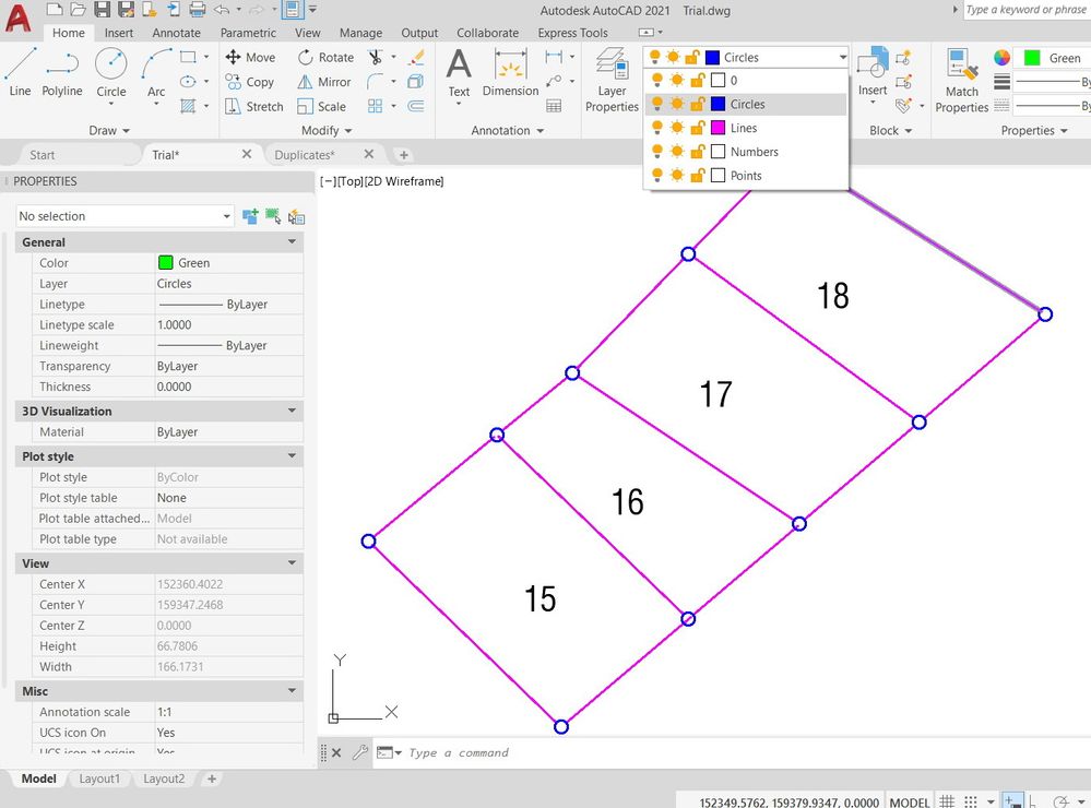

To better track the issue, I created simple data (attached) so that I can figure out what’s happening. The “extend” tool is still perplexing. It fails to wok even. Lines fails to extend
The “Planarize” appears not to be available in model builder

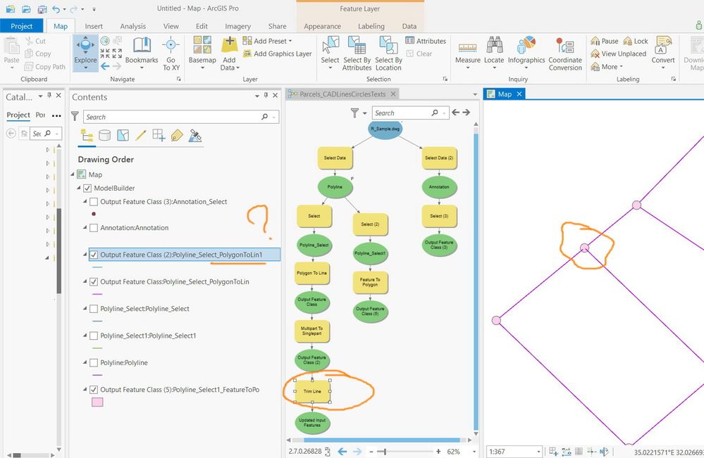

Use Trim first
Trim Line (Editing)—ArcGIS Pro | Documentation
then Extend
... sort of retired...
JamalNUMAN
Legendary Contributor
The trim never solve the issue.
