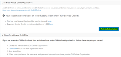

After clicking the above link, you will see a page like this, Click Activate to activate your AGOL subscription.

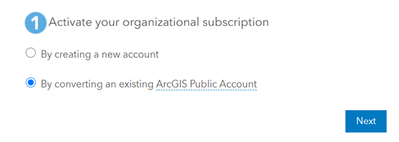

You can choose to activate your existing public account or create a new organizational account.

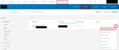

Setup your organization on AGOL, as desired. Once done, go to Oranization > Members. Click on the "..." > Manage Add-on licenses.

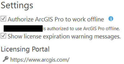

For taking ArcGIS Pro offline, go to Settings > Licensing > Check "Authorize ArcGIS Pro to work offline".
Once done, you can work offline here onwards.
